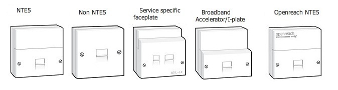

It does not look as though your line has been upgraded, your exchange may have been upgraded but your line probably won't be done for another few months unless you re-contract.  You can check what speed you should be able to get here http://bit.ly/yJGwdX.  Regardless the upload speed is still far below what it should be.
What type of master socket are you using?
and also what router are you using?

Thank you very much for replying.  I have an openreach NTE5 socket. It was installed in the house (new connection as new house) in May 2010 and we had a year an half of a higher speed profile than this.  The router is a Netgear DGN2000 - interestingly at about the time the connection slowed I could get no wired connection from the router, although WIFI was fine.  I restarted it and the wired connection has recovered.  Thank you, Edward

SOrry, the circuit sync is the same as posting your adsl stats :$. So you do have the Service Specific Faceplate, which is the main socket you connect to? If you unscrew this then you should be able to connect to the test socket at the back of this, you will however require a micro filter. My bench is to seem you have something like a HR fault purely from experience where the upstream is that low.
