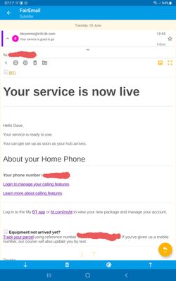

12,713 Views
Message 7 of 20
Re: Broadband (Complaint more than a Q)
  • SurfAnytime were bought by firefly, who were bought by intec business, who were my isp (via a uk-adsl login portal.. Same one as surfanytime originally gave me) until 9th  June.
BT (failed to) take over on 10th.
This is a copper adsl line, with, yes, a pstn telephone (3 extensions). You are obviously not familiar with the state of play out here in the wilds of Shropshire, where 'fibre to a nearby village' (ftnv) is still a distant (2027 maybe) dream, and pstn still rules.
P. S. But I THINK they have replaced the Strowger switches now.

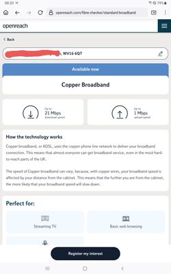

Ps if I ask openreach about fibre or broadband for my property I get this. SOTAP not mentioned.
