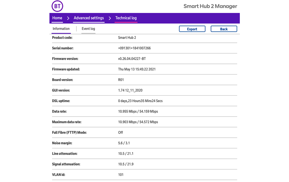

@PaddyB new firmware all recd and printing issue resolved but speed has dropped massively ?Screenshot 2021-05-16 at 12.12.00.png

Go to solution
@billybob99 thanks for posting, I'm sorry to see you're experiencing slow speeds. The router stats don't show any issues with the network as you're getting very close to the max attainable 54Mb and the noise margin is down at 3.1 which indicates there isn't any room for improvement.  Are you only noticing the issues on wireless devices?
