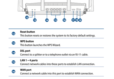

Sorry. I have used the LAN 1 port as I thought this would be the best option, but there is nothing in the manual that states that this port should be used. The LAN and WAN ports for this modem/router are as below:
In message 4 you showed a screenshot which showed WAN1 selected as the WAN port, I was asking what other options are available in that dropdown.  I presume that is selecting which of the physical ports is being used as the logical WAN port.

There is only one WAN port labelled as port 16 in the diagram above. Message 15 shows the dropdown for the WAN port in the interface. So I am now wondering from your question whether I have the use of the WAN port configured correctly.
Re your comment, "I presume that is selecting which of the physical ports is being used as the logical WAN port" I'm not sure what the selection does, and it is not addressed at all in the manual, but my guess is that the dropdown tells the router how to process the signals incoming/outgoing.
Any thoughts?

Message 15 shows the WAN type, there is another dropdown shown in message 4 (which doesn't appear to be shown in message 15 for some reason) that selects the WAN port. Not sure why there are 2 dropdowns as I would have thought that selecting the WAN type to VDSL would have automatically associated the logical WAN port with the correct physical port. Try selecting a different port number on that dropdown.

I may be being stupid but are you connecting to the phone socket using the DSL port or the WAN port?
