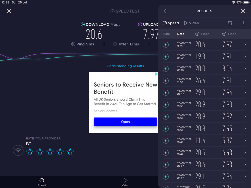

Thanks for all your advice, I purchased anew TP Link Archer AC2100, connected it up and configured everything OK, however the Broadband speed is not consistent and at the moment quite slow, most time I can get just below 30Mbps, but some days like today it drops to 20Mbps or has been lot less.
I have used Speedtest and directly from the TP Link  router to measure speeds and they are both the same, so its not my iPad or mobile phone that's causing this, it appears to be the speed from BT exchange.
I have seen that I need to leave the router on so BT can increase speed on a steady line, which I have done, however if I report these slow speeds to BT will they be able to test to my TP Link router as I dont have the BT Hub attached.

@noopy66
Speedtests can vary considerably depending on overall loading of various servers.
Somewhere you'll find the connection stats and these are what we need to see.
