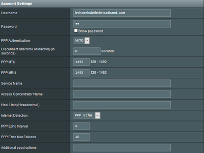

@DillanColleer
Where did you buy the Asus from as I think it might just be faulty?
I don't suppose that the Account Settings page DOESN'T match mine - specifically the Disconnect etc setting:-
That's the only setting I could think of that might affect things.
The other thing is that you have a fault on the line that the Asus can't recover from whereas the SmartHub can. My son has the same Asus as me (and you) and was losing the internet quite regularly so we initially put it down to the Asus being faulty but I tried it for a week with no issues at all and he went have to the SmartHub with no problems until he realised his speeds were dropping and the SH2 was frequently disconnecting/reconnecting without him knowing. He talked to other neighbours , not all with BT , and they were having speed issues. Eventually OpenReach found & fixed a problem and his Asus is back up & running successfully.

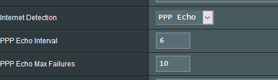

@DillanColleer
Been looking at this a bit more and the photo shows the default settings for PPPEcho in the Internet Connection page:-
Suggestions are to lower the interval to 4 (secs) and the max failure to 4 also. This results in the loss of PPP much sooner and may make recovery work better. Worth a try perhaps.
The suggestion mentioned by @Les-Gibson was for a totally different issue.
