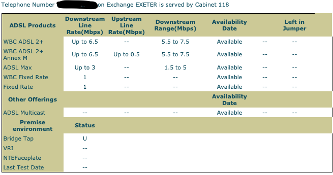

Thanks - Quiet line test seems fine. I only have cordless phone but no crackles etc
ADSL results attached + view of speed from the hub.Screenshot 2019-07-24 at 10.49.30.pngScreenshot 2019-07-24 at 10.44.23.png

you speed problem is due to you being put on adslmax and not adsl2.  I have asked mods to see if they can help you get on adsl2  they will post here

Hi @patricki  welcome to the forum and thanks for posting about your broadband speed. I'm sorry that you have been connected on Adsl max when Adsl2 in available and offers a better connection. We will be happy to help get you changed over. I've sent you a Private message explaining how you can contact the forum moderation team.

Thanks for taking the time to send us a direct message @patricki. I called you to discuss, sorry I missed you.
I have placed an order to move you over to ADSL2 and this order will complete overnight.  It may take a few days for the line to stabilise after the change.
