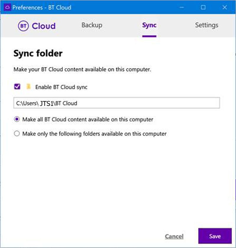

Is your D:\Drive not a secure Backup recovery drive?
Also in your Preferences on both Laptops, have they been set to C:\Drive and D:\Drive respectively?

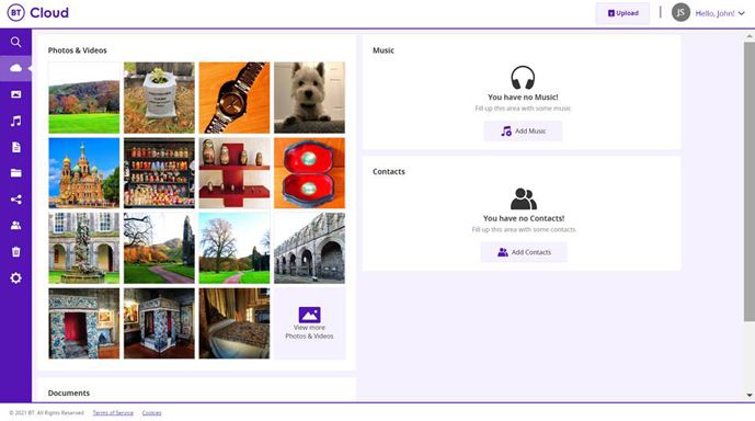

At the top left of screen next to the (blue or green) syncing icon there is a Folder icon, which opens your PC/Laptop BT Cloud Sync folder.
To the right of the Folder icon is the Web icon, which looks link a Globe, this icon opens the log in page, where you log in using you User name and Password.
This will open BT Cloud – My Activity.
If you have successfully launched using you User Name and Password, you will now be on a page with a Tab at the top called BT Cloud – My Activity.
You should be able to see 10 icons down the left hand side of this page:
  1. Search………………….   Self explanatory
  2. Cloud……………..…...…Photos and Videos
  3. Mountain…....…..….....Albums - Favourites
  4. Musical Quaver….….....Music
  5. Sheet of paper…..….....Documents
  6. Folder………………....…All My Files
  7. Balls tied together…....Shared Files
  8. People…………….………Contacts
  9. Bin…………………………Deleted Items
  10. Cog wheel………………Settings
When you arrive on this page you will be at 2. Photos and Videos.
To the right there are examples of these displayed (if you have any), but also note that at the Bottom Right of these, the last space is occupied by a link to More Photos & Videos.
The right of the screen is dedicated to Music and Contacts.
If you choose 1. All,
this will display the same as the link to More Photos & Videos.
If you choose 2. Albums,
this will display all of your Albums, but this can take many seconds(or minutes) depending upon how many there are and how many files the folders contain. It currently takes me 20 seconds as I have over 300 Folders containing a total of more than 20,000 files.
If you choose 3. Favourites,
this will display any files that you have chosen to be your Favourites.
If you choose 4. Music,
this will display a list of any music files that you have.
If you choose 5. Documents,
this will display a list of any document files that you may have.
If you choose 6. All My Files,
this will display a list of the origin(s) of your synced files.
If you choose 7. Shared Files,
this will display a list of the files that you have chosen to publicly display to others by sending them a file. This is my favourite part of the BT Cloud, and I would be more than pleased to demonstrate it to you. This is not where you create these files, but it is where you can revoke them.
If you choose 8. Contacts,
this will display a list of your chosen phone Contacts.
If you choose 9. Deleted Items,
this will display a list of your deleted files that you can either restore, or delete forever.
Finally, if you choose 10. Settings,
This will display your personal Account Details and current Cloud Usage.
Let me know when you have looked at these, so we can proceed further.

On both laptops they have been set respectively. Laptop 1, where I use a second hard drive in my machine (D:\) for BT cloud syncing, I have D:\BT Cloud set in the preference as that is where my BT Cloud folder is.
On my second Lapatop I have C:\Users\"my name"\BT Cloud as this is where my BT Cloud folder is on this drive. It initially worked on both laptops but now I just get error on both. Even if I uninstall Cloud from one of them and only use the other laptop it still wont sysn. The error is identical on both machines which makes me think that the problem may be coming from the cloud server.
In the preferences I only use the Sync Tab. In The Backup I do not have any folders checked because I do not need to use it. I only need the syncing. I also have the same files in both BT Cloud Folders on both laptops and these files are also online on the cloud. That's because it used to sync. Shortly after the new update I had some issues, I sorted them and it was syncing. Shortly after it stopped syncing and hasnt been for over a month. I have actually been waiting for BT thinking that they  were working on it because I've seen others with the same issues, but its been more than month.
