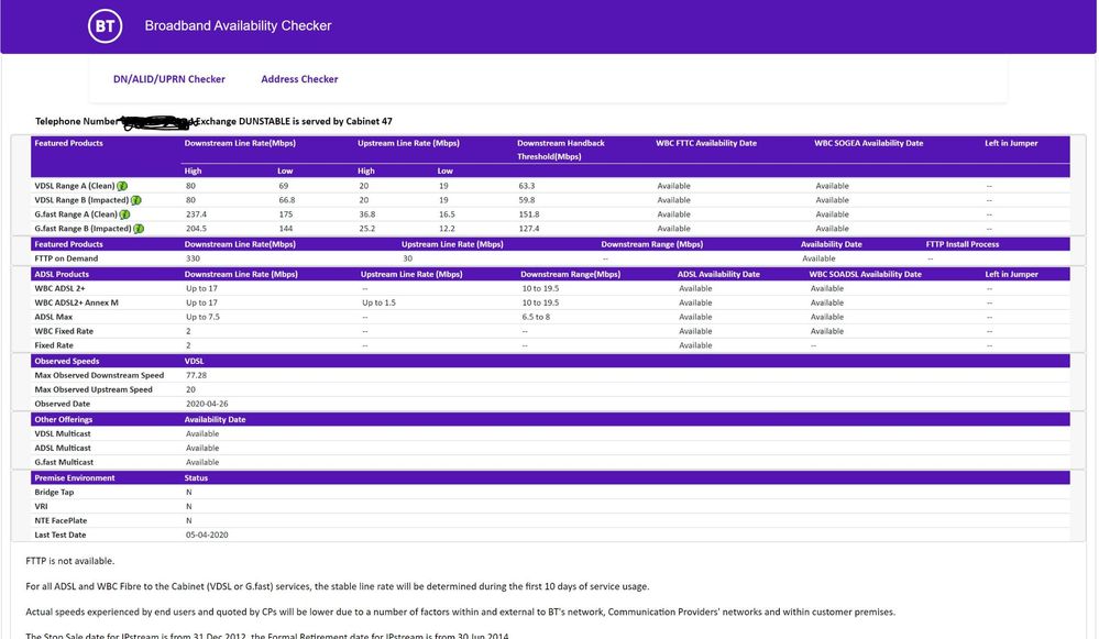

Here's the info from the BT wholesale website as requested:
Thanks

from the dslchecker results your speed was 77/20mb on 26/4 and has really gone downhill in last couple of days
is quiet line test still ok?
if line now appears stable don't really want to change anything and cause another reset
