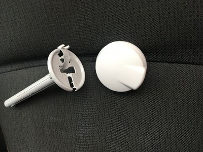

Sounds like a sloppy install, unfortunately they are becoming more and more common.
What the Engineer should’ve done is drilled a 10mm hole then widened it internally to 12mm to fit an Internal Lead In Kit, as pictured below.
That way the plug covers the drill hole and offers some protection to the Fibre Cable.

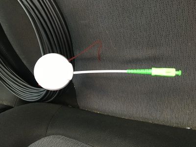

It is not the reset and I do not want to hack it. It failed minutes after it was set up. I run the diagnostics and suggested to turn it on and off. The engineer came back from the van and staight away told me that it is not a reset.
He went ahead and started installing these green bits one after the other. After five efforts or so, it worked. But I am not sure whether that was the problem.
The hole is huge. When he removed the protective layer and the fibre is left exposed, it is on the air. From there it goes to the green bit and straight to the white box which is not that stable.
After ending up cutting the cable again and again, there is not a lot of cable left. I do not like the huge hole on the wall but I do not want and I do not have anything to fill it up. I do not like the fragile fibre hanging there. I do not like the fragile white box.
All that is installed next to the radiator. That installation position was the big stress of the day as I was taken by surprise that I would need to make this decision and I do not like it where it is.
For me, the whole installation is fragile both internally and externally. There is no way a fibre installation can survive kids and pets. Outside it is the same.
I have to pay the bills in advance. When I asked them to reduce the delivery as that was the latest offer, they could not do it. They explained how it works but it was like they could defend everything.
In the contract it says that if the problem is at my part of the property, I have to pay for it. But now as it stands, the whole fibre to the premises is not part of my home. Well it is when it comes in but that was not there and it is so super fragile that it can collapse and then who knows how much I will pay to fix it.
I am not sure whether they will come back to check it internally. I have the old copper sockets and they are bomd proof. He cut the old copper cable and now I ended up with this super fragile fibre and no phone.
That role of fibre from the photo is cut and thrown away. The plastic cover for the fibre does not exist. It straight from the wall, white fibre, green bit and wall box that it is not stable.

Ah, what you are describing is a method called, FFC, Field Fit Connector.
Openreach started using it a few years ago as it got rid of the need to splice, which meant they saved money not having to give every Engineer a £6k Sumitomo Fusion Splicer.
Unfortunately FFC’s have a high failure rate of 25%. Hence why Openreach have started to go back to using Splicers, although they are now providing Service Delivery Engineers with these cheap Swift ones that would be better used as a door stop.
Most Engineers have now been trained up in splicing but there’s a few still around who haven’t and are still fitting FFC’s. Unlucky for you, you got one.

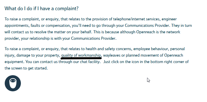

@apav  You can make a complaint to Openreach about the install HERE,
You can also ring the FTTP team about your connection. 0800 587 4787
