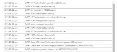

I would encourage anyone experiencing the upload speed issue to first check the Event Log in the Hub Manager.  There do seem to be a number of examples where resetting the Hub might undo the Hub parameter update if already implemented by BT.  In my case then the update was evidenced by the following CWMP events. See screenshot.  You can filter the Event Log to just show these events by selecting TR69.  Usually this will show a daily connection at the same time every day where the Hub checks-in with the ACS to check for updates (usually event code 2) and in my case an event 6 at another time of day where the event was initiated by the central server.  It was this event that changed the parameter and corrected the issue for me.  Not sure what event code is and if anyone can advise then I would be interested to know.
Hope this helps.

I've had my Fibre 900 for a couple of days and have the 50Mb throttle on uploads. My Event log looks exactly the same as AandB 's but it hasn't corrected the problem yet.  Can you help please ?
