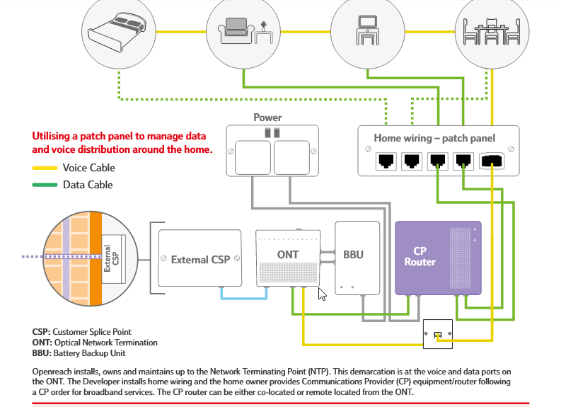

You mean this?

@Mateusz19 wrote:
Hi,
This is what they said:
  • BT points to living room with master socket located under stairs
  • Ethernet points to living room and separate kitchen / dining area (where applicable) and master bedroom
I would have no confidence whatsoever in what the developer says if they refer to 'BT points'. You need to pin them down and ask if Openreach have provided fibre or copper infrastructure to the development and if not fibre, why not.
