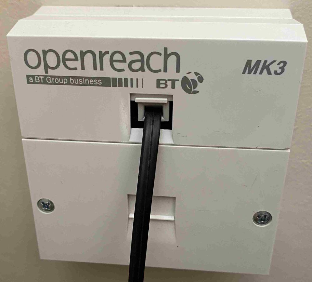

Also attached is the master socket I have installed. I used to have a normal socket previous (I believe this is numbered 1 on your diagrams)
The BT engineer changed to number 7 when he last visited last year.

The picture you have shown, is not the 5C (no7 on my image)

Sorry.
My mistake. Looks more like number 6 BT socket.
