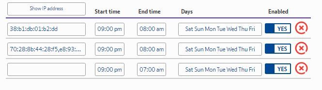

On my new Homehub6 (which was a recent replacement for a faulty one which decided not to issue DHCP addresses any more), the Access Control Lists are not working. I have static IP addresses for all of my kids devices as I block them at night. I added an ACL for my daughters phone by IP address while she was connected and pressed Save. It then showed the MAC address rather than IP address. I added my sons laptop by IP address and pressed Save and it showed the MAC address followed by a semi colon followed by the MAC address of my own PC, which was then blocked after 9pm. Needless to say I had never entered this device into an ACL. I added my sons phone whilst he was away from the home pressed Save and the box just showed a blank. Last night the router started blocking my house alarm and my BT Whole Home Wifi devices from accessing the internet. There are no references to these devices in the ACLs. I also noticed that if you look at connected devices, some devices that have DHCP addresses show up occasionally as Static, and some devices that are online at home do not appear in the list at all. Resetting the router has no effect, nor does deleting all ACLs and starting again. A recent firmware upgrade on 6th June to version SG4B1000E016 has not fixed the problem.
I reported this to BT and they sent me another replacement Homehub6 this week. I have configured this offline with just my laptop plugged into it. I added 3 access lists by IP address, none of which are in the MAC table, press Save and in place of the IP address it now shows 2 lines (not 3) of MAC address 00:00:00:00:00:00. If I then try to add a 3rd line and save it it just ignores it and shows 2 lines.
Is anyone else having similar problems. Is this a firmware issue?
I would be grateful if anyone could offer any advice as to how to resolve this problem.

@mod, thanks for posting the guide again, but this doesn't address the issue.
The how to guide is great in as far as it goes - it clearly shows how to set-up access control. The issue I am experiencing, similar to the above posts, is not one of the set-up which I have done multiple times in sync with the how to guide. The issue is what happens next, once it's been set up:
1. Access control set-up for iPhone1. Settings saved and tested and all working ok.
2. Shortly after (could be minutes or hours) the control set-up have no impact and another device stops working
3. Check settings, and iPhone1 is now not shown as having any controls, and has been replaced by iPad1 or AmazonFireStick or TV etc
Even when only one device has a control set, it randomly changes to another. This must be to do with how IP are allocated. I have tried setting each device IP to fixed in the Device settings menu within the router, by this doesn't help either.
