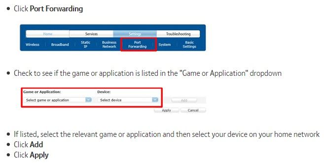

Ok, as far as port forwarding goes you first need to create the rules and then apply them to the IP address of your camera. The first part of your screenshot is ok, but you need to delete the second part and just forward port 8883 rather than the whole range that you have forwarded. You also need to add a third port 443.
Once you have created the rule assign it to your camera, see https://www.bt.com/help/broadband/learn-about-broadband/how-do-i-set-up-port-forwarding-on-my-bt-hub...  for further info.

Could you please lay out for me how the numbers should be entered as I am getting an “Invalid entry” message ...how do I show 8883 in the two fields for “Port Range” and similarly what do I do for “Translate to”
Presumably 443 will be added the same way?
i have checked your link but it misses the bits to add I am struggling with

If entering a single port number, just put the same number in all 4 fields. I haven't got a HH4 so can't give you step by step instructions but I think you should be able to select the camera. Ideally, you should give the camera a static IP address on the device itself and allocate the rule to the IP address but if not, you should allocate the rules to the device name i.e the camera.

I think that once you have created the rule (with the name shown in your screenshot)  I think you need to go back to this screen select the new 'Game or application' that you have just created  and select the camera in the 'Device' box .
