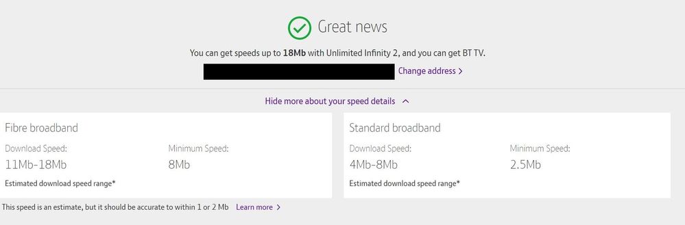

The estimated download speed prior to upgrade was 11Mb-18Mb (within 1-2Mb) with a minimum speed of 8Mb, so I'm not expecting any fault investigation from BT given the resulting connection speed.

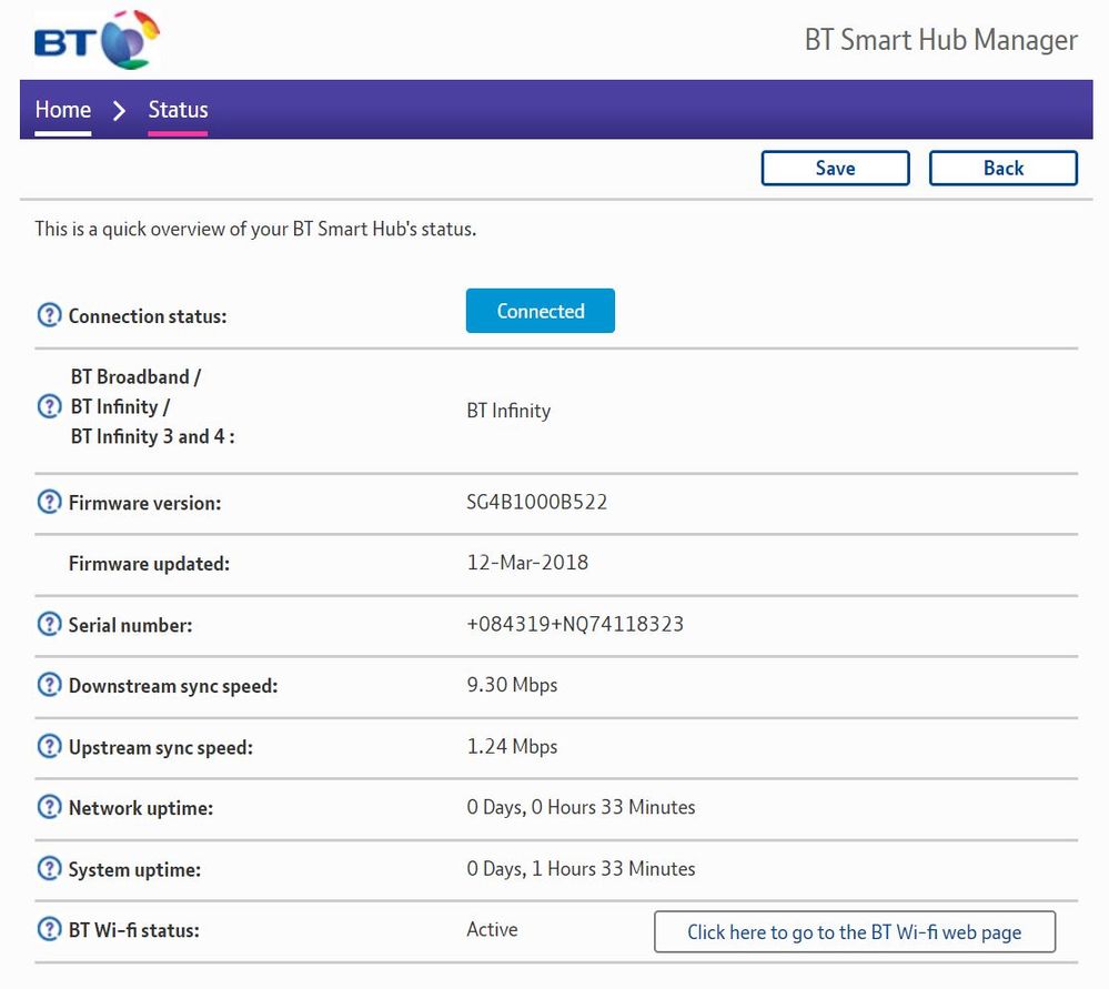

The initial connection speed frollowing the upgrade was 9Mbps, so I removed the faceplate on the master socket and connected the hub directly to the test socket, this seems to have helped increase the line sync to 12Mbps, but equally I guess this could just be the line stabalising generally.

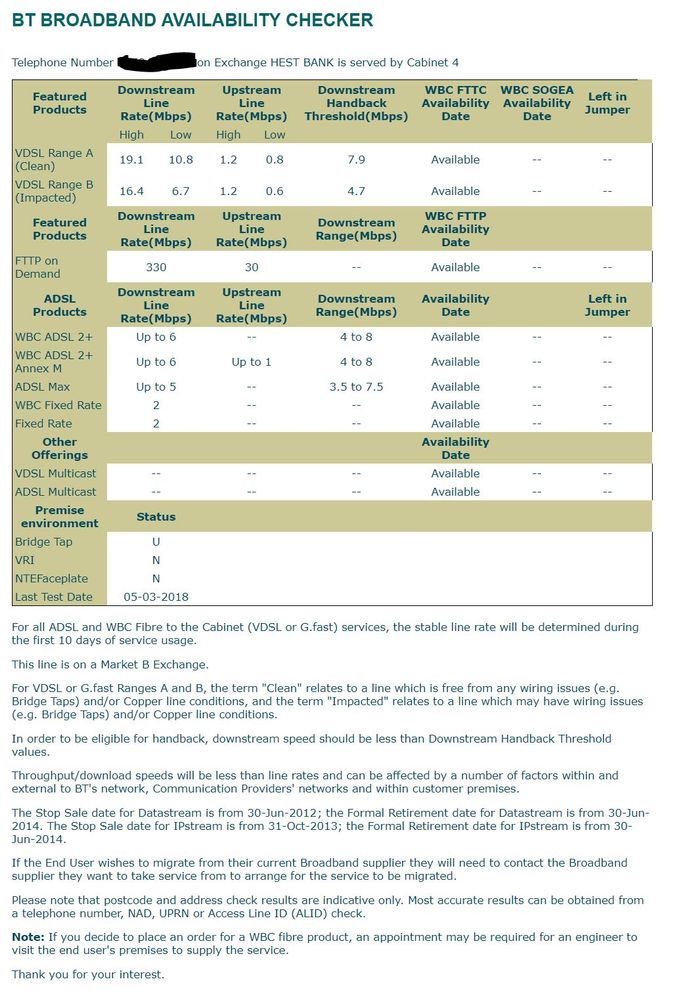

from the information you have posted you are getting speeds within estimate - just the distance from the street cabinet is the problem as you can see from graph  you could try conencting to test socket with a filter to see if that makes any improvement

Thanks, that's a good graph and makes sense.
According to samknows.co.uk we're 1.14km from the local exchange (Hest Bank) but I'm not sure how far away from the street cabinet we are, I'll have a scout around for it (Exchange HEST BANK is served by Cabinet 4).
I'd be surprised if it was further away than the exchange though, or is it likely that it's just the exchange?
I think the phone line comes in over ground, but I'll do some more investigating.samknows-exchange.JPG

Based on the improvement in stats when you are connected to the test socket there may be an internal wiring problem. It may be best for a short while to leave the hub connected to the test socket so as to avoid too many disconnections if it's not too inconvenient.
I did notice on the screen shot about the speeds quoted it referred to Unlimited Infinity 2. Your parents should NOT be on this but Unlimited Infinity up to 52Mbps , or even the cheaper Infinity 30GB monthly allowance if applicable. They may have to ring Customer Options to try and downgrade  0800 800 030.

The upload profile shows that your parents aren't on Infinity 2.
