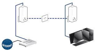

If you don't want to run Ethernet cable you could consider using powerline adaptors. You plug the master one in to an electrical socket near to the Smarthub and connect the Smarthub to the powerline adaptor by Ethernet cable. You then plug the slave powerline adaptor in to an electrical socket near to your TV and connect your TV to it by Ethernet cable.
This shows how it would be done using a PC but it would be exactly the same with your TV.

One thing to point out, if you have a UHD youview box and you probably have given you have FTTP, is that power line adapters won't work for a UHD stream. You will need a hard wired ethernet cable from your smart hub to your Youview box.
regards
