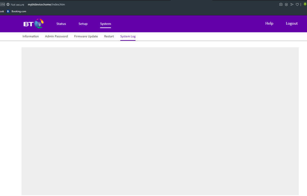

Many thanks for the prompt reply. In answer to the process you posted, I have followed those steps twice this evening and end up in the same situation.
I've pulled on all my IT support knowledge of the last 22 years within the service management arena and cannot understand as to why this has happened.
The issue arose around 3 weeks ago and still have not been able to resolve the problem.
Below is what some of the web pages look like!

Same story here. Can connect the Ip-address of the system but below screenshot shows up. App can't connect neither.
