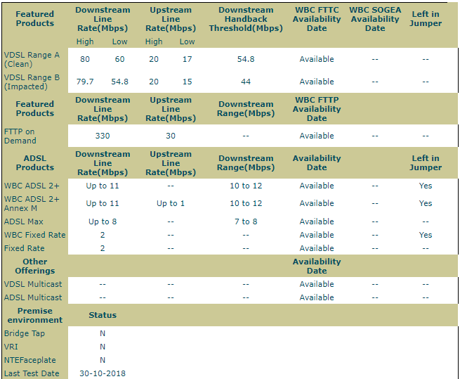

And here is what dsl checker says:
Ive been monitoring the noise level on my line and it wont go below 6db even though ive ran a quite line test and there is no noise on the line, ive read that bt are lowering noise levels to 3db and this can help improve speed. DSL uptime is alos usally about 7/8 days before it resets.

the speeds quoted by BT are connection speeds not download speeds  you have 49mb connection speed but handback speed is 55mb but you stats show your attainable as only 49mb  I would expect on a good line to get the 55mb without the help of G.INP
are you using the test socket with a filter even if you currently have a filtered master socket to see if that improves your connection  when you conenct to test socket can you repost your hub stats

the 42mb you quote is download speed but all speeds quoted by BT and the checker are conenction speeds and your attainable is still at 49mb so get engineer visit to see if they can get you to at least 55mb
