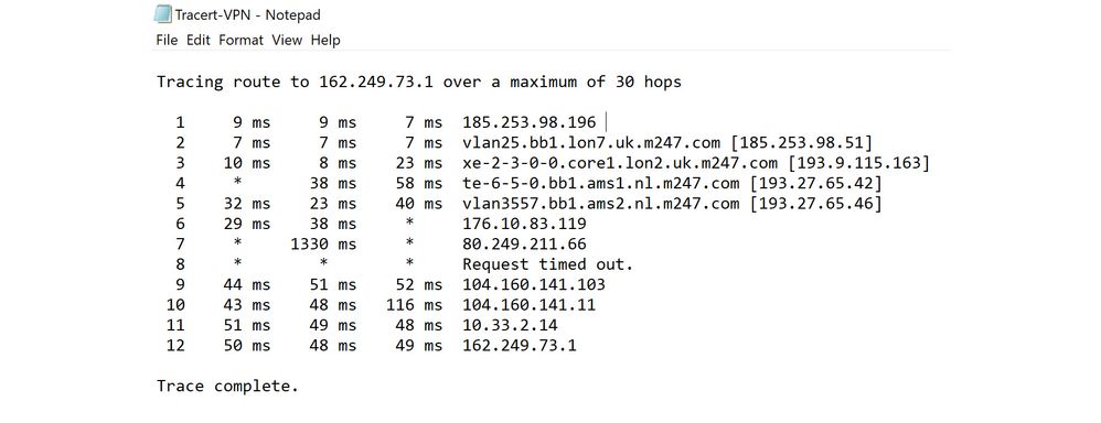

I am able to connect using a VPN (This bypasses BT showing its a problem with BT routing) and have also spoken to BT on the phone which they then stated "We can only provide a speed test as you aren't using a BT router".

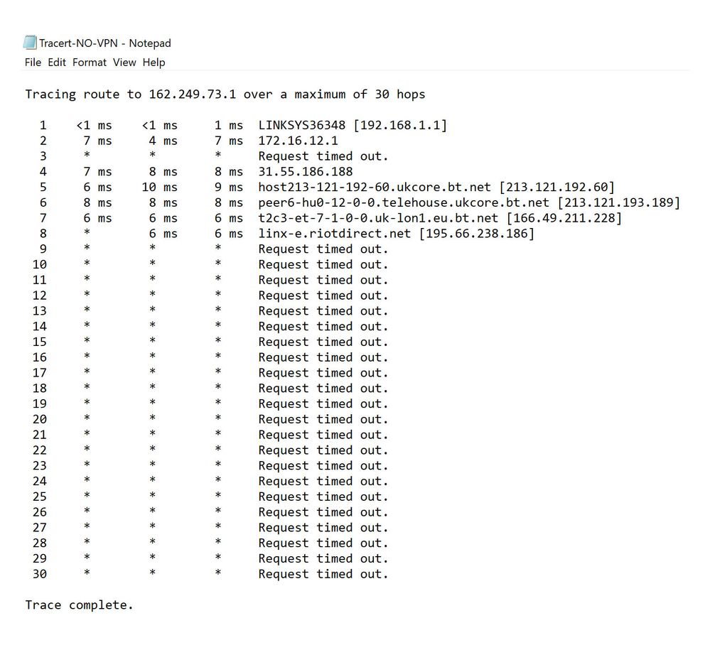

I have provided 2 tracerts to the server which i connect to for League Of Legends (162.249.73.1).

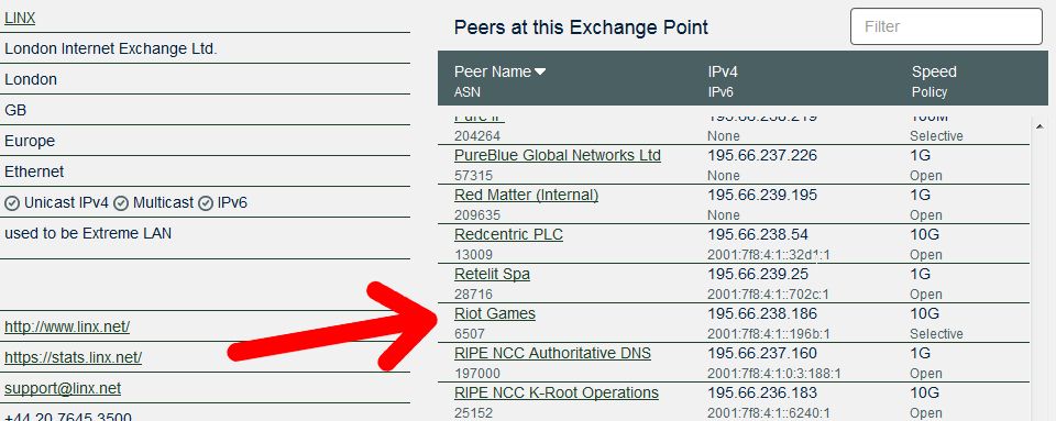

From your tracert it appears to be a problem with the Riot Games peering.

So it seems changing our modem out for our old one did the trick.
Not sure why but its all working now.
