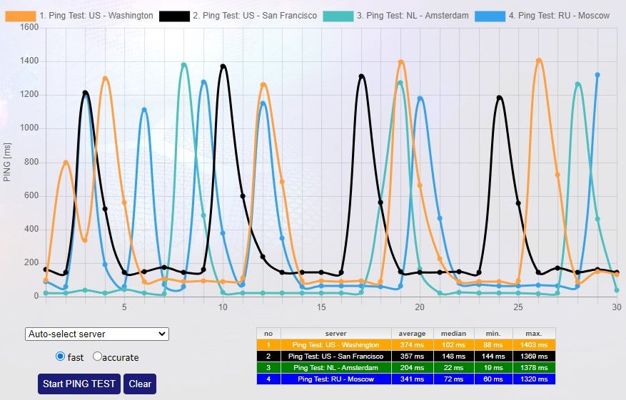

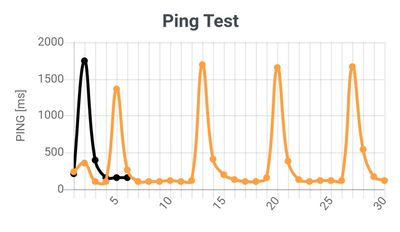

I have been having an issue with my Internet for over a year now whereby its speed is drastically slower than quoted and I have consistent ping spikes up to 1500ms (see image)

Screenshot 2021-02-04 163319.jpghere is a screenshot showing the issue persists across all servers pinged rather than just one, also just thought it may have been openreach that moved my line back as opposed to BT

Could very well be the case, but in that case what is causing the return of the ping spikes.
As you can see from the graphs its a pretty distinctive regular spike.
Perhaps I was too hasty to assume the line was swapped back.
Yesterday after the fix we had 54 down and stable 17ms to Amsterdam. After the short downtime today we are back to below 5 often below 1 mbs
With 17 ping as normal but spikes to 1500 every 5 seconds
