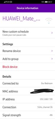

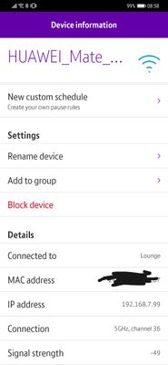

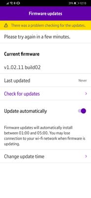

I've just bought the 3 disc whole home wifi and am having a couple of annoying problems that I'm hoping someone can help me with. Firstly I can't update the firmware using the app , it just comes back with 'there was a problem checking for the updates' each time. I've changed the DNS setting for the main disc to 8.8.8.8 but it still happens. Secondly my phone isn't swapping to a better (closer) disc unless I disable and reenable WiFi . I can be connected to the disc upstairs , come downstairs and it doesn't swap to the main disc even though the signal strengths when I'm downstairs and it's connected to the upstairs disc are -83 (upstairs) and -49 (main disc). I bought this on the promise it would act as a mesh and devices would swap to the best access point seamlessly, it's pointless if it stays connected to a disc with a far lower signal strength and link speed. It's a hauwei mate 20 pro phone if that makes any difference...

Just to clarify something, if I'm connected to the upstairs disc and go downstairs it stays connected to the upstairs one until I disable WiFi on my phone and reenable it when it immediately connects to the main disc in the lounge. All I want is for that to happen automatically...

Ok so I think the fact my phone isn't switching discs is an Android thing, my wife's and daughters iPhones / iPads both switch automatically so I'm not too worried about that aspect of things. All I have you do is switch WiFi off and back on again to get my phone to switch to the nearest disc which takes a few seconds so no big deal. Can anyone help with the firmware update problem though? I'm currently on 1.02.11 build 02, I think there's a later firmware although I have read it's caused some issues so am I better leaving things as they are anyway and not upgrading to the latest firmware?

I don't have a solution as such but I was in a similar situation. I also recently installed the BT Whole Home WiFi and at the time had a Huawei Mate 20 Pro mobile. It would hang on to a particular disc for too long even if the signal became quite weak and the only way to force it to move was to disconnect and reconnect at which point it would connect to the closest disc. All other devices (a mix of Apple phones and tablets and some windows laptops) seem to move fine. This week I upgraded my phone to the new Google Pixel 5 and this moves perfectly between each of the 3 discs. So in summary it isn't an Android issue but is perhaps a Huawei specific issue.......

Can anyone help with the question about updating the firmware? I've tried doing it using the app and via the web interface and it fails using both methods saying 'there was a problem checking for the updates' . I'm at a loss what to do about it , is firmware update working for everyone else?

Hi @zAndy1
Just to check, are your discs connected in the UK and not using a VPN? The firmware server is only accessible in the UK.
