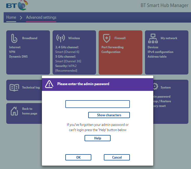

5) First things first, head over to Advanced settings, and click system. I personally change the Admin password so i dont have to rummage through BT Homehub passwords to access the advanced settings, but you can keep this as default if you need.

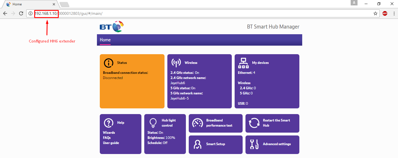

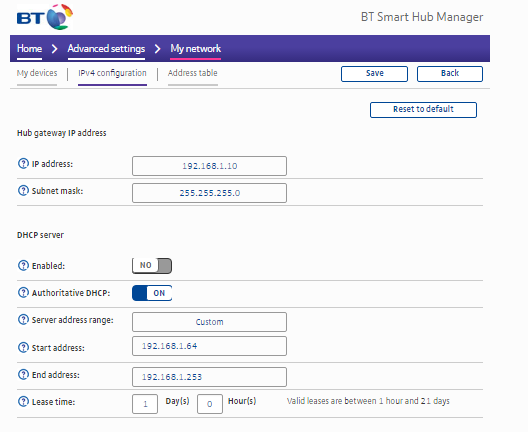

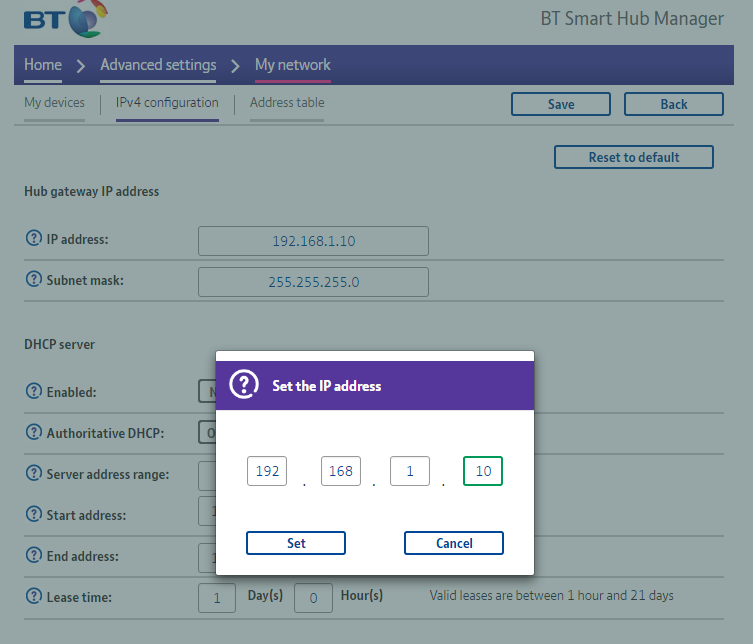

6) You want to head over to My Network, IPV4 Configuration and change the Smart Hub's IP. Depending on your router your ip scope may start at a different range, but if your running a HomeHub on the network, then anything under 192.168.1.64 will be fine. I changed my HH to 192.168.1.10.
7) Your internet browser will timeout, now enter your new IP Address what you gave the HH and you should be greated with the HH's interface (If not, restart the hub and wait for it to settle down)

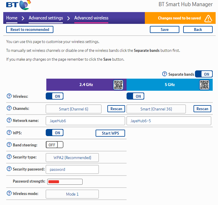

😎 Next, lets change the wireless settings for the HomeHub, Click advanced settings and select wireless. I prefer to seperate the Wireless Channels and Call them something Unique, you can leave them as default for peice of mind, or customise it for ease of acessibility. (Don't call it the same as any original WiFi networks as you could have trouble accessing both routers) Don't forget also to make a strong secure password for your WiFi networks.

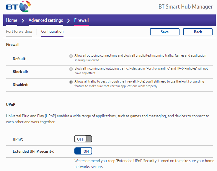

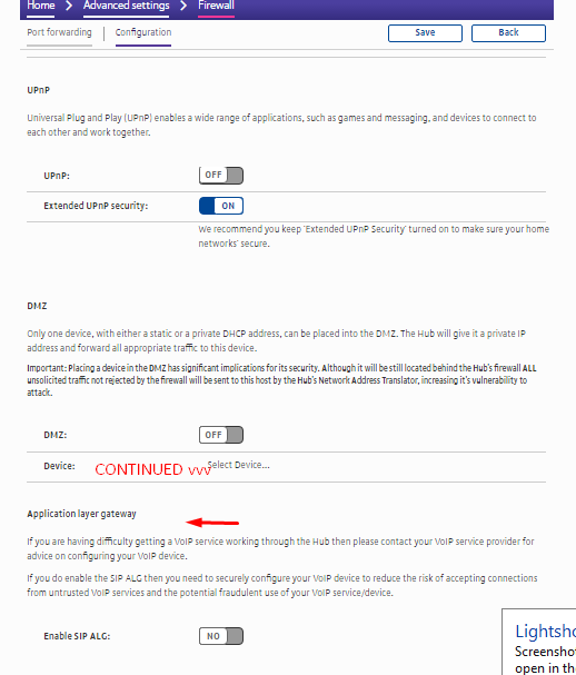

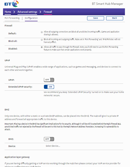

9) We need to configure the router firewall, dont worry about your second firewall as your main firewall will be on your main router/modem. Head over to Advanced Settings, and Firewall, we need to turn off the firewall and also disable uPnP as this will be a access point/extender connecting to the original network. *BUT MAKE SURE YOU KEEP EXTENDED UPNP SECURITY ON!
10) We need to Turn off DHCP on your HH, Go to Advanced settings, IPV4 Configuration and Turn DHCP server, and Autoritative DHCP off as it will pull DHCP from the main router.

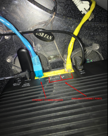

11) save the changes, RESTART THE HOMEHUB and then you want to plug a ethernet cable (or another measure of connectivity that is connected to the main router eg. WiFi Hotspot) into the LAN4 port on the back of the HH, and then plug in your computer in another LAN port (LAN4 always must have the Ethernet connection from the Main router)

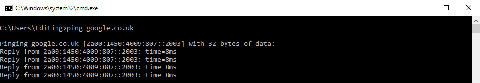

12) See if you have internet connectivity, you can open up a web browser, or command line and ping a website, also you can go to the 2x different HH's on the network (If your already running one) as they will be on the Same network but on different IP's allowing you to access them anywhere on the network.

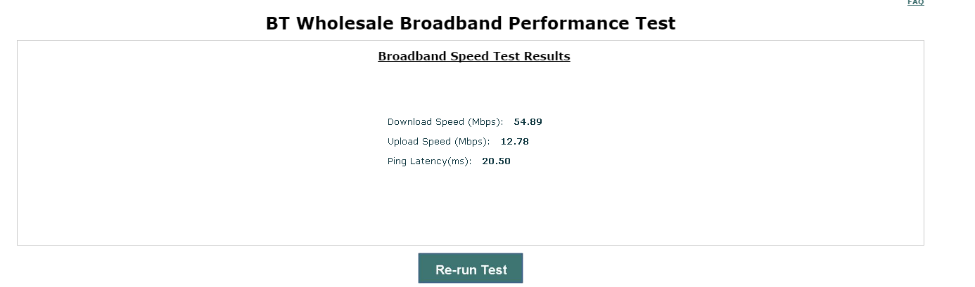

13) Test your internet speed, it should be the same as your main router (depending how your connected via port4) give or take 0.5 mbps.

Make sure you turn on Extended UPNP security, otherwise you will get no internet access via wireless. (FIXED)

Here are the screenshots from my setup that hopefully will be able to resolve yours, let me know if you run into any problems and give me a shout if you find the problem 🙂
- Once again, sorry for the late reply, had a lot of things to sort out busy busy at the moment!! Smiley LOL
Screenshots: (NAVIGATION AT THE TOP)
Might have something to do with the Authoritative DHCP, try changing that and let me know!
- Regards, Jaye.

Yes, i believe that should solve the issues, the Authoritative DHCP should be turned on, my mistake in the post.
Try turning that on as i believe it just allows the homehub to address devices, but not actually use DHCP on the current router (basically not assigning addresses based on its own configuration, in thoery if LAN is working it should already forward to your main DHCP server)
