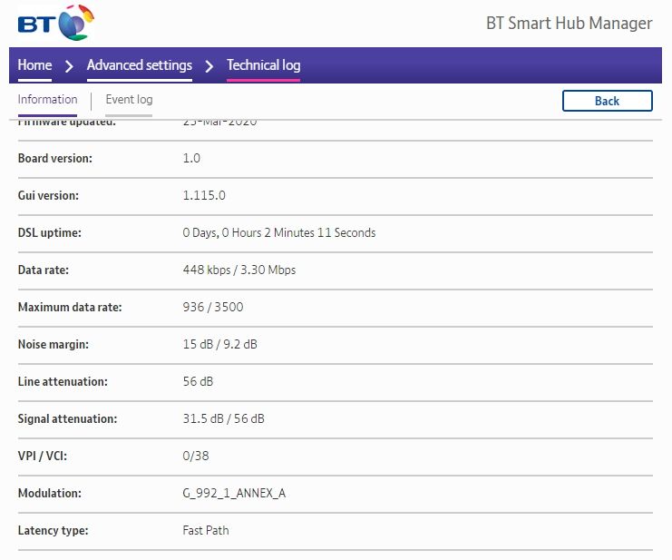

Hello.
Normally, my download speed on my BT phone line ADSL is 3.8 to 4 Mbps, but for the past 2 weeks it has been reduced to just over 3 Mbps.
The noise margin is now 9.2 dB, which is too high and indicates a problem.
I have always used the master socket, which includes separate connections for broadband and voice, so no need for a splitter.
I have not changed any hardware at my end, and I am still using my BT Smark Hub (HH6) which is using the latest firmware SG4B1000E020 (23 March 2020).
I have attached a screen dump of the appropriate settings from my HH6.
BT HH6 SettingsBT HH6 Settings

connection time is only 2 min is that hub dropping connection or manual reset?
can you check for line noise  dial 17070 option 2 should be silent and best with corded phone

It was a manual reset by me.
Done the silent line test and no sounds at all.
I have also included the line information from the BT wholesale test.

Re: Big reduction in download speed.
as you can see your connection speed is within the expected range so unlikely BT will do anything at present.  If you can keep a stable connection then your noise margin should reduce and speed increase automatically but could take few weeks of stable
I see you are on adslmax and adsl2 is available to you.  I would doubt the change would give you any faster down connection speed but I would expect your up speed to increase from 448kbps to 800/900kbps. so maybe not worth the effort

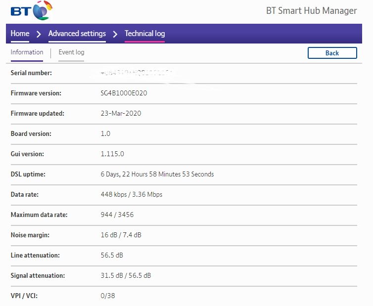

Hello.
As I suspected, there has been no improvement in my ADSL profile and speeds.
There is clearly an issue with my line and its profile, so this needs to be passed to the relevant people.
I attached the technical settings page from my BT Smart Hub (HH6).
HH6 Technical SettingsHH6 Technical Settings

from looking at your stats your speed has increased slightly and noise margin reduced since your last stats but connection time only 6+ days.  your attainable speed is only 3.4mb so at 3.36mb you are just short and maintaining connection you may get the bit extra as noise margin falls to 6db.
3.4mb is about average speed for your 56db attenuation which is just over 4km from exchange
