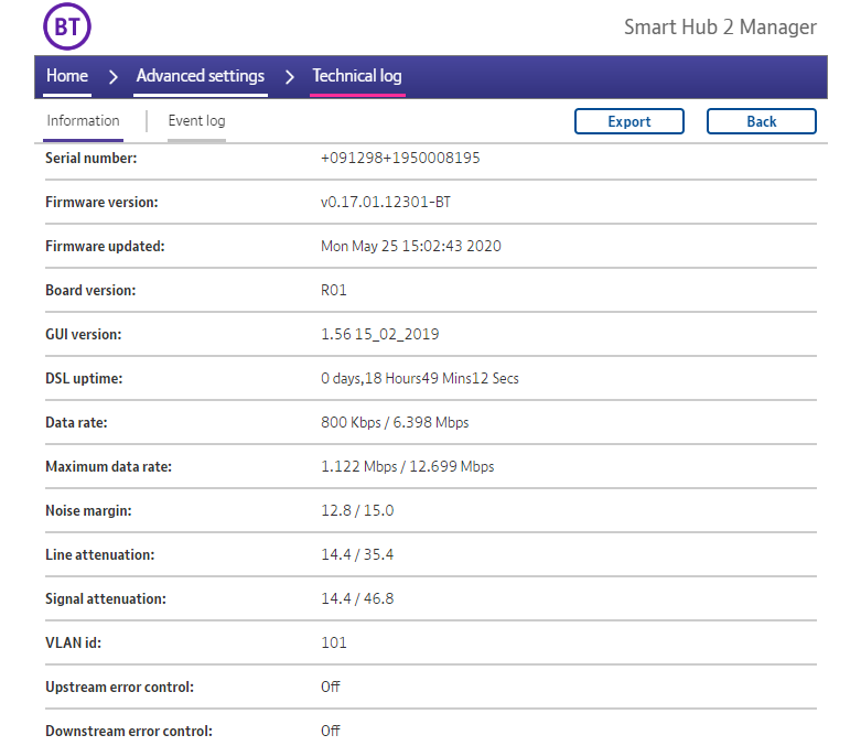

@ClarachDave
I may owe you an apology, it didn't appear.
OK so the MAX you could get is 11.4 likelyhood to the router will be less, and then it depends how you are connecting to the router.  What suprises me is you mention fibre (in this case FTTC) and you appear to me to be on that.
The checker shows 4.5 for ADSL 2+
Go here to get the stats:
Stats should look like:
what info should be displayedwhat info should be displayed
 If you can post that it would be great

Looking at your stats your attainable speed is 13mb but at present your connection speed is only 7mb but your noise margin is high at 13.3db suggesting connection problems with line dropping.  If you can get a stable connection then noise margin down to normal 6db then your connection speed should move closer to attainable and above 10mb. As you are on a Huawei cab then once stable connection then DLM should activate G.INP which will give a boost to your connection speed by lowering noise margin nearer 3db and taking speed further over the 10mb you are looking for
need to find cause of high noise margin and fix your line

No problem,
Here is the stats page. This is a problem which has been going on for a while, and is our reason for changing from talk talk to BT. Frequent disconnects, particularly in wet weather and low speeds has been a feature of our internet here for ever. It used to be because our lines came over from Aberystwyth and were too far away from the exchange, but apparently there is now fibre in the valley below us, but it doesn't seem to have helped a great deal.
Possibly we are on fibre 'technicaly' but,HubStas2.png if we are, the cabinet is probably 800m or more of copper away. The fibre seems to stop about 500m away from little our hamlet of houses and nobody gets reasonable speed. What would be really helpful would be a discussion with somebody about the cost of 500m of fibre and a cabinet and how we could work that.
dave

From the information you have posted your are on FTTC - fibre to the cabinet - and then normal copper line from cab to your home.  However from your speeds your line length is a lot longer that your estimate as can be seen from this graph
If you are using test socket and still dropping connection and line is silent then you are going to need engineer visit to get stable line and therefore speed increase

I think the high noise margin and line problems could well be due to us being somewhere over 2km from the cabinet. The cable is all on poles thorugh farmland and woods.

Re: Broadband Fails to meet USO
