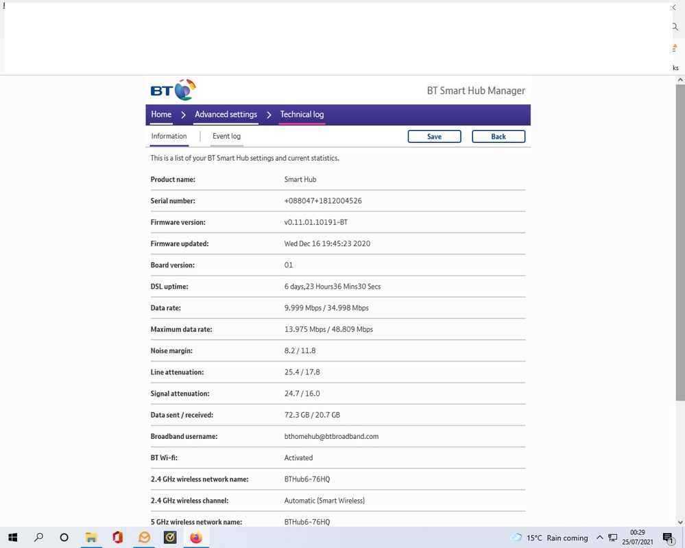

in order for the forum members to help please can you post the stats from your router (if hub enter 192.168.1.254 in your browser) and if  HH5 then go to troubleshooting then helpdesk and if HH6/SH2 then advanced settings then technical log information .

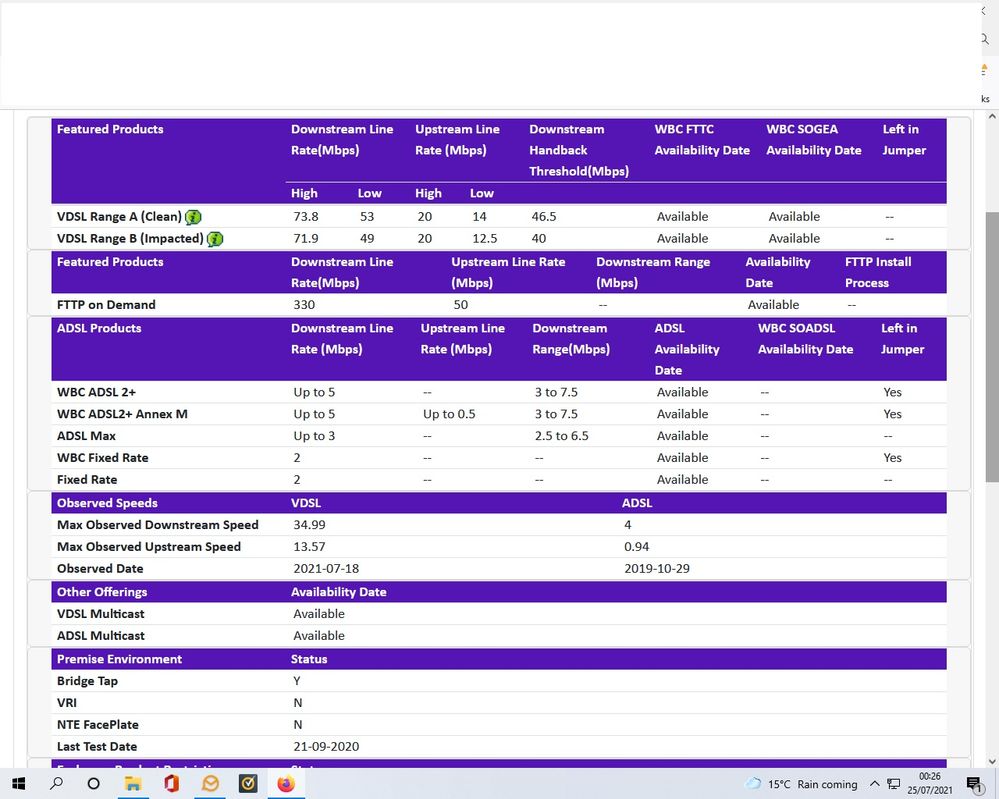

enter your phone number and post results  remember to delete number   https://www.broadbandchecker.btwholesale.com/#/ADSL

from what you have posted were you having problems with your connection dropping or maybe doing resets to try and improve speed or maybe both  Looks like even though you have 6 days stable you are in a banded profile hence why stuck at 35mb.  your upstream was 13mb on 18/7 but now down to 10mb
have you tried using the test socket with a filter to see if that improves your attainable as actual as banded will not change
Dslchecker suggests range 73/53mb

That could easily be the reason your connection speed is not within the expected range shown on dslchecker
