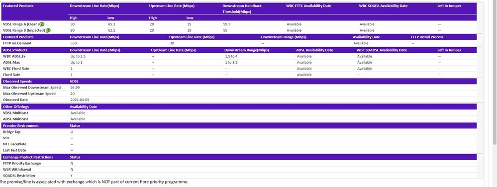

My BT app shows Fibre 2 package. The text message I received requires me to book an Openreach engineer appointment, but I'm a bit  uneasy about doing that due to the risk of a callout fee. The BT customer service rep I spoke to on the phone, thinks there's nothing is wrong with my line.
I used to get 74mbps down when I first had the Sky max package, but over a year ago now I started getting line drop outs, it took 3 openreach engineers to solve the issue, although they could never trace the fault, the engineer switched me over to a new fibre board in the cab and my speed settled at around 64/18 from then on.
https://www.broadbandchecker.btwholesale.com/

Quiet line test?
Your choice, its not going to fix itself.
You were getting 65M down 20M up on the 5th April

Re: Broadband issues New fibre 2 customer
No it hasn't, see message 6 and your checker screenshot.
