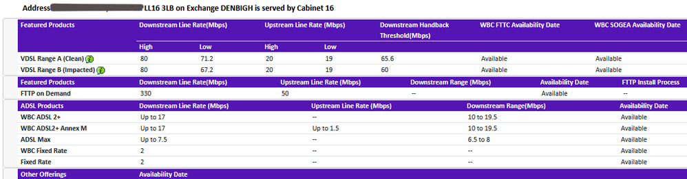

Looks like you can get it but you may have to take out a phone contract first so the database can be updated and then upgrade to fttc.
