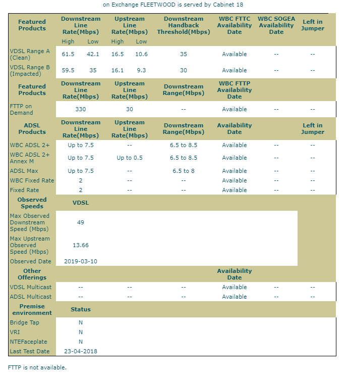

You are currently connecting at 49Mb however I notice your DSL uptime is only 15 hours. Is this due to a manual reset?
Could you also post the result of the DSL checker not just the bit you think I want. Also exchange and cab number.

1,457 Views
Message 7 of 13
Re: Bt superfast Fibre 2
Go to solution
@TheSeasider
Please remove your phone number from that posted image, as this is a public forum. Thanks.

DONE!!

@TheSeasider wrote:
If I knew HOW TO I WOULD !!! It took me over an Hour to work out how to get That Image up there !!!
I see you have done it now, thanks, its for your own protection.
My guess is that if you leave the connection alone for a few weeks, DLM will increase the connection speed.
