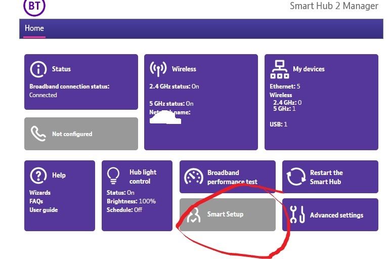

As @garybs29 has said, if your hub is purple, you have no connection.
Its not a wizard, it is an on/off toggle.
It is not visible from a mobile device, you need to access the hub from a laptop/PC.

Do I have to open a website to do this? This was not mentioned as a requirement by BT at any stage?

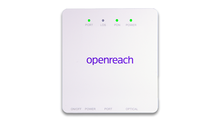

The fibre doesn't enter the house at a wall socket, you should have a fibre modem (ONT) which connects to your Home Hub. The lights on the ONT shouldn't be flashing. The Power light should be on, the LOS light shoukld be off and the PON light should be steady green.
The ONT will look something like this

I do indeed have an ONT modem with green lights, connected to the hub. Upstairs. Downstairs I have my LG smart TV connected to my TV box by an hdmi cable. There is also an aerial from the roof connected to the TV box. And a power source.
