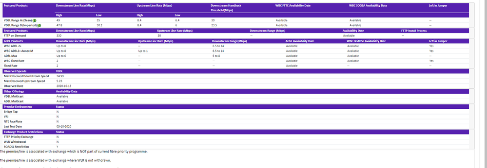

Recently getting into streaming via Twitch, Youtube etc and requires a better upload speed.
My router says
5.092 Mbps upstream speed, so when streaming I have to use around 2500-3000Kbps
I called BT once before and they mentioned 5-8? anyhow, here's a screenshot below of the line. Don't understand it myself.

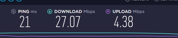

Also speedtest:

The easiest and quickest way would be to upgrade your internet connection as FTTC is available according to the jpeg you posted

As far as I'm aware, we are on the top speed package... I remember running a package check a few weeks back, only higher ones give us the extra wifi hubs etc to put in rooms but no increase in speeds

If you have an idea upload speed of 5mbps but only need 2-3 Mbps, you should have plenty but you may find the speed to be lower if you're connecting via WiFi

No, I can only use 2-3 out of the 5, or it lags like crazy. Also all through ethernet, I don't use wifi
