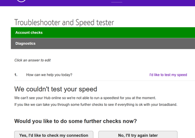

I couldn't perform a BT speed test without the HH3 so I've plugged it in now but it says "We can't see your Hub online so we're not able to run a speedtest for you at the moment."This is the same wired on PC and on mobile phone BT app.

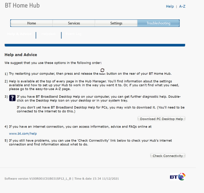

I also cannot check the HH3's router stats/logs using 192.168.1.254. I've tried to follow the guidances online but can only see the following page
Please advise what I'm doing wrong. Do I need to wait for BT to recognise it or call them to activate the Hub or something (I can get online though).

If you are using the openreach modem in conjunction with HH3 then all the connection stats are held by the modem not the hub. You would need to unlock the modem to get stats

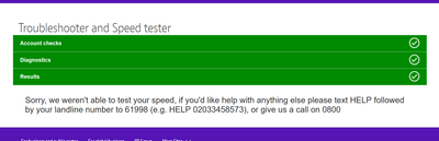

I'm still not able to sign into my BT account to run speed tests or check connection sadly 😞
3rd party speed tests current show 24-25Mbps for my Fibre Halo 1 but the App says download speeds estimate will be between 45-71 Mbps. Will BT staff be able to see my details?

Thanks. So I won't be able to see my modem details as it's locked and there is no other way to check my details? Would BT staff be able to do this on their side?  I'm still unable to check anything about my connection, any stats or even a simple BT speed test. Was hoping to avoid calling if I could get self help from here (and learn a thing or two)   but does this mean that my only recourse is to contact BT who would be able to see my technical details and speed test at their end?
edit.
Would BT be able to give me a new Hub with the modem integrated into it so I can check my stats? Also what about disconnecting the old ECI modem and making the HH3 a modem and use my Orbi router as the router (would it be hard to do this?)

Yo need to ask BT for a replacement hub, provided you are still in a contract?
You would not need the modem, and would be able to see your connection information.
The HH3 only works on standard (ADSL) broadband.
