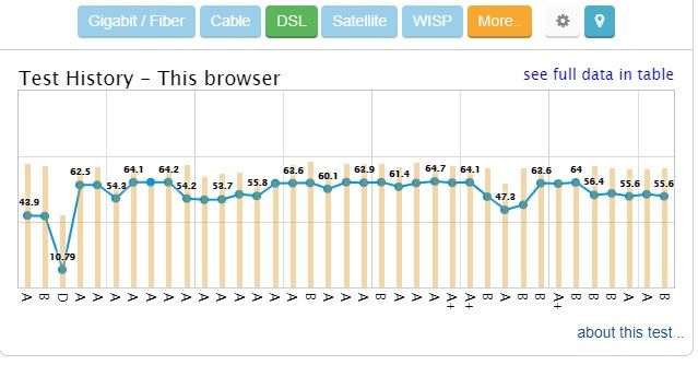

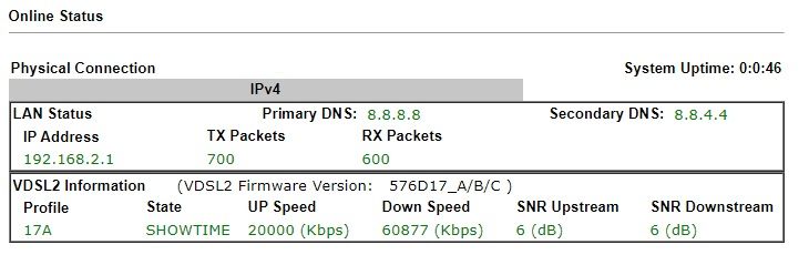

3.jpghello,
see below. just to repeat, this issue has only happened since swapping to BT. I have a load of latency and bandwidth intensive applications that immediately were not happy the day of the switch and have worked fine for 4yrs prior. The QoS module red-flagged a bandwidth issue as soon as started a video call via VPN. no noise on line silent dial test.
also added line history. the earlier tests are playing with the QoS profiles and wireless. all the others are done wired with the QoS rules capping the DL at 95% of max. last 5 are on BT are with old QoS bandwidth, so the line is capping out.
