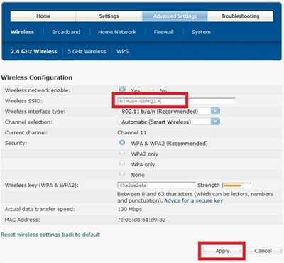

5.  From here you can change the SSID name being broadcast. In this example here we've added 2.4GHz at the end of the name to easily identify this as the 2.4GHZ band. But you can change the name to anything you want. In the Wireless SSID section enter a new name and clickApply
6.  Click Yes for the changes to be applied
7.  Now you've changed the SSID, you'll need to reconnect any other wireless devices you've previously connected
Update - When you follow the above process for changing the SSID of the 5 GHz Band you will see an option which reads 'Sync with 2.4GHz' This option need to be set to 'No'.  I have added a screen shot below,
