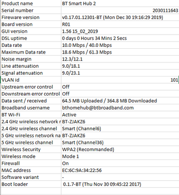

welcome to the BT community forum where customers help customers and only BT employees are the forum mods
please can you post the stats from your router (if hub enter 192.168.1.254 in your browser) and if  HH5 then go to troubleshooting then helpdesk and if HH6/SH2 then advanced settings then technical log information .

Re: Connection repeatedly dropping to 1/10 of advertised speeds.
4,188 Views
Message 4 of 12
