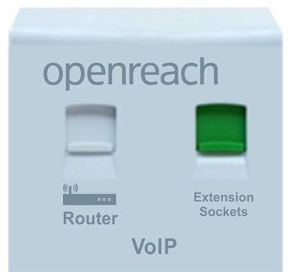

@Starwire2 wrote:
I did have a photo of one on my old work iPhone SE but recently upgraded it to an iPhone 11 so don’t have it anymore. If I see one next week at work I’ll get photo for you.
Just found this on a Draytek site. https://www.draytek.co.uk/information/blog/the-end-of-analogue-phone-lines-pt2
