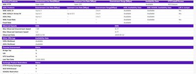

Is your property a new build or an older property with a copper pair service and an overlay FTTP network ?
Perhaps you can port the results , if you enter your BT phone number or your address ( if not currently a copper line BT customer ) if you use this site ,
https://www.broadbandchecker.btwholesale.com/
More info is required to offer anything other than a ‘guess’ as to what the delay is, perhaps your address has mistakenly been shown as having FTTP available when it isn’t, or there is an issue with the ‘spine’ network back towards the OLT ( the headend equipment ) , which wouldn’t necessarily be easily spotted by you if all the local infrastructure exists,  leading you to think that there cannot be anything other than an ‘admin’ problem stopping you getting connected
If your order is with BT , there is a BT FTTP number you can call, they may be able to explain what the delay is.
