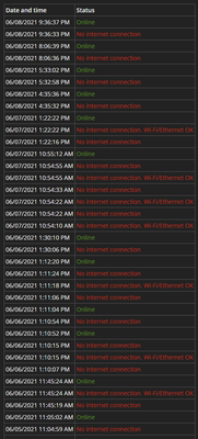

I had an engineer out on the 11th of may to investigate a slow connection issue, in doing so he swapped over my wiring? to my flat in the buildings basement. Since then I have been experiencing disconnections for 3-14 seconds multiple times per day. This is incredibly disruptive, especially when trying to work or game. This happens on wi-fi and ethernet. I have tried changing routers and ethernet cables.
The strange thing is the BT engineer came today at 3pm. (It's currently 11pm). They reverted the work they did on the 11th and had my internet offline for a while, which can be seen on the hub below.
In between then and now I have disconnected four times which were not picked up by this Network uptime.

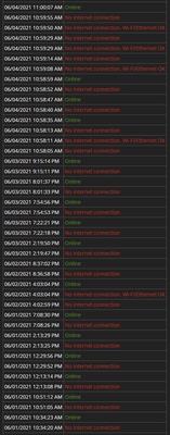

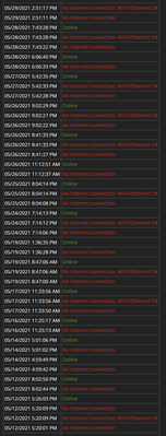

Below is some examples showing my disconnections since the 11th.

So I had a disconnection at 02:05:05 seen here.
Here is what it said on my router at the same time.
