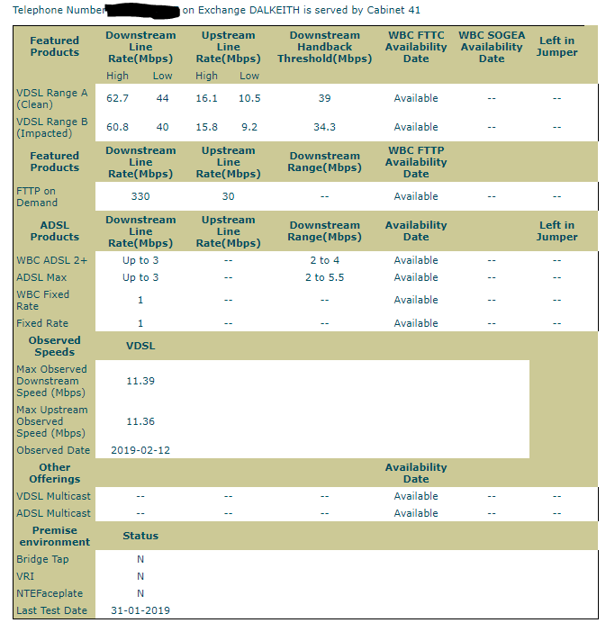

can you post results from dslchecker?
2,365 Views
Message 3 of 26
Re: Download speed dropped to a quarter of my "minimum" speed. Speed checker says my speed
Go to solution
Hi, I'm at work at the moment so will have to do the router stats and quiet line test later, but here's the dsl checker results:
