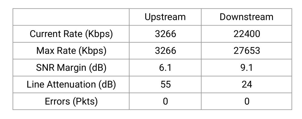

This image is from my router settings page.

b is bits B is bytes. Routers and speedtesters always report bps whereas file transfers usually show Bps. Where are you seeing 2.5Mb/Bps?
