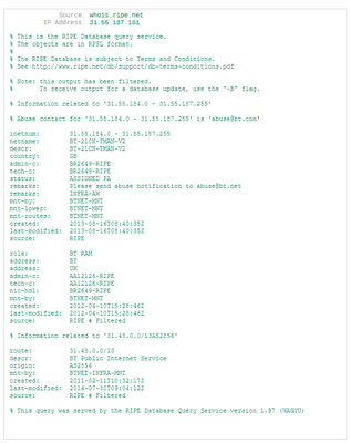

So I was advised to make my own thread so here I am. I've noticed an extreme amount of packet loss recently while using my interrnet. There has been no corresponding loss of speed but there are just spikes of 2 second response times for ping requests. Here's the pingplotter graph to google. The other plotter tabs show the exact same IP as having a problem (ping plotter, google, FFXIV server and my internal network IP)
As you can see there's an extreme amount of packet loss coming from 31.55.187.181. When I do a WHOIS lookup it shows as one of BTs own servers
I know that pingplotter shows my BT hub as having 50% PL, but when I do a ping request to just that IP it shows 0% PL so I don't think there's a problem with my hub or network.

It's not packet loss exactly, the node just isn't supposed to (imo)  respond to ICMP requests but does for some reason.
As long as the packet loss doesnt carry over to the destination hop it isn't an issue.

Hop 1 (BT Hub) is your local LAN, so from the device being used to test to the HUB.
Hop 2 is (I think) an IP in the exchange. This IP is configured to respond to ICMP for some but not others (It doesn't respond for me)
anything else after that is obviously BT or other network infrastructure as you've found.

There is no problem. Packet loss at intermediate nodes is meaningless if all packets are received at destination. Packets can't get miraculously recreated if they are lost. Intermediate packet loss is only relevant for diagnostics when final destination has packet loss.
