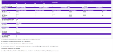

Secondly I live on the 5th floor and top floor of a block of flats. I have access to the loft and it looks like the current wiring goes into there through a central room behind the lift shaft (1st picture) the 2nd picture shows where the wiring goes down the wall to the master socket shown in the 3rd picture. I believe this was installed not that long ago before I moved in, you can see the plasterboard has been cut in line with where the white tube goes down. From my understanding I will need a new socket installed for full fibre, will they be able to use the existing ducting for this and place the box near the master socket or will they simply replace the master socket with the new one? I don't need a phoneline.
If anyone has experience with this do you think this will be a straight forward install? My main concern was getting the cable up to the 5th floor but as it looks like everything runs up through the middle of the building and then into my loft that should hopefully be fine.

It shows WBC FTTP is available to me and they note it's a MDU. I don't really want to order if it's going to be a massive hassle to be honest.

I've just checked and the 2 blocks of flats next to me both say FTTP on demand so it seems weird that mine is the only one with it available. Hopefully that means someone has already had it installed in my block and the wiring is all done.
There's definitely a central comms/service room for each floor where all the other cables run up. In the 1st picture where all the cables enter into my flat you can make out the top of a ladder in a service room.
Assuming it is straight forward to run the cable up the comms rooms and into my loft with all the other cables, my main question is - will it be possible to feed the fibre cable from the loft down the same plastic tube as my current copper cable and then replace the Openreach master socket with the new ONT? Or just install the ONT alongside the existing master socket?
