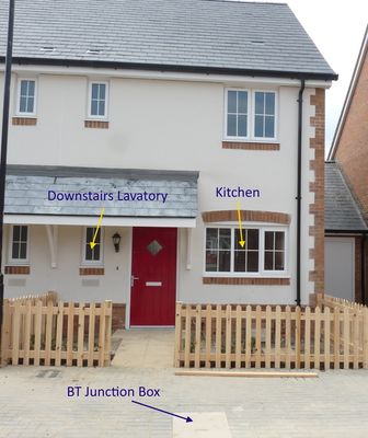

As you can see from the photograph below you can see that I am fortunate enough to have BT trunking to the front of the house (built 6 years ago).
Telephone cable in!Telephone cable in!
However, from the picture you can see that the house builders (Charled Church) just drilled a hole though the wall to feed the internal wiring to the BT point in the hall. Behind this wall is the kitchen (and kitchen cabinets) and no power supply!
I am assuming that there is no internal ducting for the cable! The hall is not the ideal place for a modem/router so when the house was being finished I asked the builders to run a telephone extension socket into the understairs cupboard. I have been successfully running my modem/router and associated NAS stuff from this extension socket. There is no trunking (conduit) from this extension socket to the master socket in the hall so assume the cable is buried in the floor somewhere!
The house is a semi detached house with the kitchen on the right hand side of the front door and downstairs lavatory on the left. The BT junction box is just outside our gate, so very convenient for us and BT.
Front of house.Front of house.
As mentioned earlier there are kitchen cabinets against the outside wall of the kitchen. I am wanting the fibre to feed the Openreach supplied ONT into my router, which is in the understairs cupboard. From the front of the house there is the downstairs loo, then staircase - understairs cupboard.  Is getting the fibre feed through to the understairs cupboard going to be my challenge?   Will I have to drill through the lavatory wall and feed/install flexible conduit behind the plasterboard into the understairs cupboard?  Should I wait to see what the Openreach engineers suggest?

OK Chaps, sorry no further forward! Openreach were a hive of activity in middle of September, man down hole (Picture 1)  said "You will have FTTP by end of September!"
Now beginning of November and we have seen nothing of Openreach for 6 weeks! Have managed to work out a way to get fibre optic cable into house but need to ask here for info relating to the cable size! No Openreach engineer to ask!

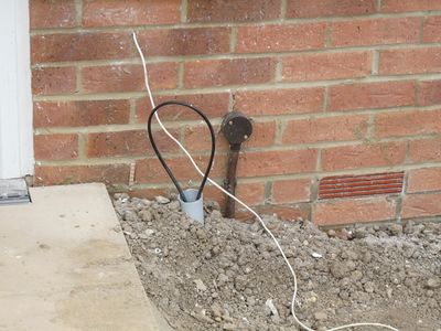

In an earlier post Starwire said that hole size through wall needs to be 10mm (No problem already done, see Picture 2). Then indicated that the inside needs to be widened to 12mm for the internal lead in kit.
My questions are (a) what diameter is the fibre optic cable? and  (b) will it pass through my conduit (internal diameter 6mm)
I am planning that the conduit will go up into the attic (via the internal soil pipe trunking!) and down behind the plasterboard into my understairs cupboard. Some 15 metres or so.
Any help is appreciated. Many thanks and stay safe!
Edit: I now see (another posting by Starwire) that the current fibre offering from Openreach is about 8mm in diameter so will have to change my conduit to an internal diameter of 10mm. Not a problem as nothing set in concrete, yet!
