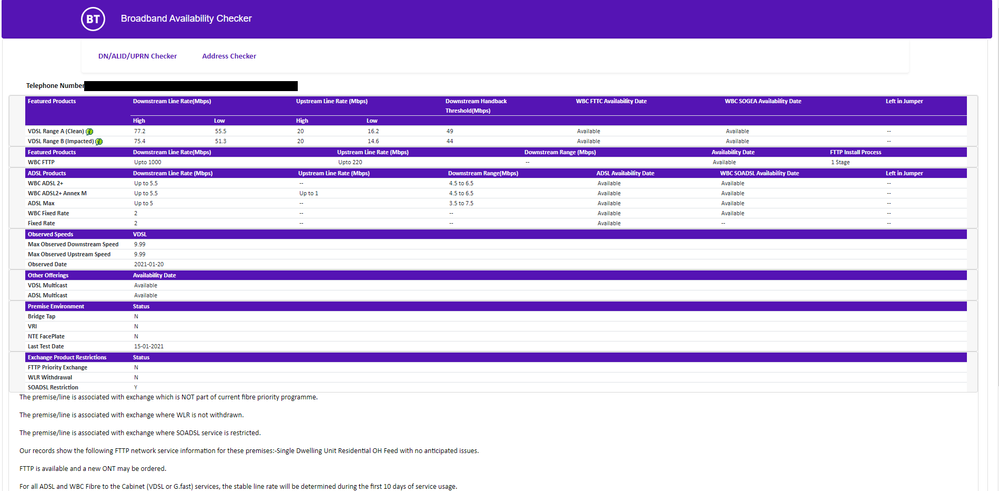

@samjo
Welcome to this user forum.
Enter your phone number into this form and display the results here, but edit out your phone number before you post the results.

Hi Keith, thanks for replying.
Here's a screencap with my landline removed. 😊
