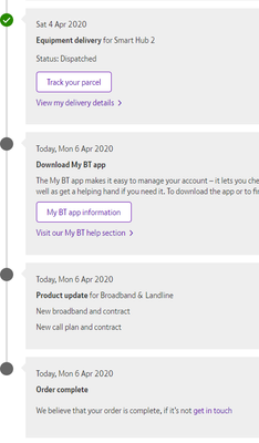

upgraded today but seems my download is throttling goes from 500-800. tried on smart hub 1 and 2 with Ethernet cable plugged in.
also not showing my order is complete either. i was told they had to plug my cable into a new 500-1gb "racking" at the exchange. i'm hoping they bumped me up on the system but i'm not on the new racking yet.
I will power off the ONT and HUB tonight when I sleep and ring up in the morning if no improvement.
Do you think it's the smart hub 1+2 causing this and worth investing in a new router?
