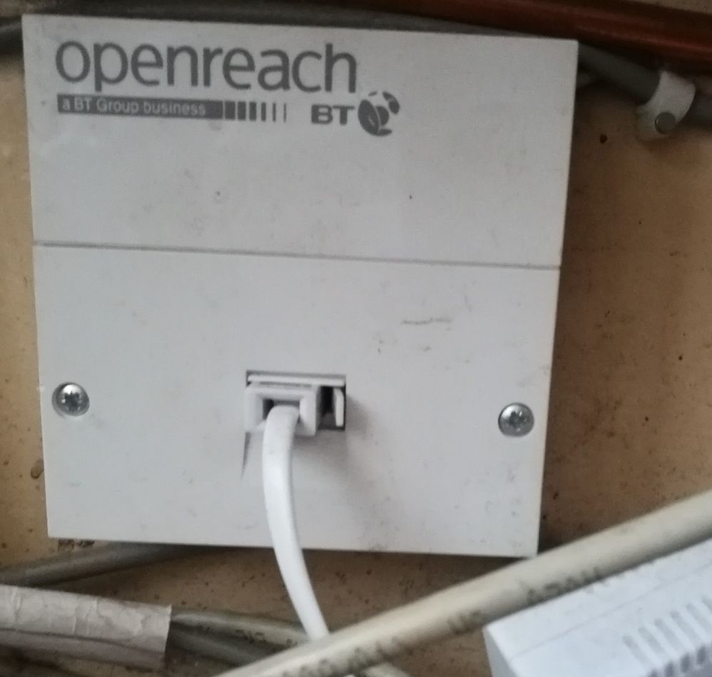

I've checked and the line is silent using the quiet line test.
This is the only socket we've got - do I need to open it up to access the test socket?

@MrsJCP
that is master socket and if you undo the screws and take of front you can then see the test socket.  then insert a filter and then connect your hub to filter and leave it and see if that helps your stability
