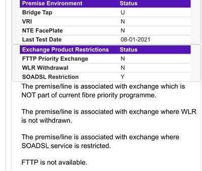

I live close (<1 mile) to my BT exchange, my neighbours around me all have Fibre BB. However my property seems to be an exception and I can only get standard ADSL (8-10mb). I have a feeling OpenReach haven’t routed my cables to the cabinet for so reason? With a family of 4 working from home and two gamers in the family this is making my life miserable 😩
I don’t understand the attached readout. It suggests that Fibre isn’t available? But I know that it is. Can someone please help explain what’s going on here as BT are no help whatsoever

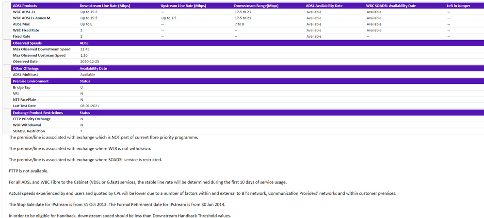

can you post the full result from the dslchecker - that is only the bottom part
leave exchange and cab information

@sundean
The last test showed you are getting a connection speed of 21.45Mbs, so that is quite good for an ADSL connection, and more than adequate for most people. Some people on fibre (FTTC) get less than that.
As you are on an EO (Exchange Only) connection, you are not going to be able to get a faster connection. That is not likely to change.
Your connection showed Telephone number xxxxxxx on Exchange GRANTOWN ON SPEY. You posted that before you edited your post.
Other properties nearby, may be connected via a fibre cabinet.

Not sure where 21mb result comes from? I can assure you I’ve never seen anywhere that speed. I run a Speedtest regularly (daily) and have never seen more than 12mb at best
What does Exchange Only mean? How come my property is EO and my neighbour(s) is fibre (cabinet) then?

the 21mb is your connection speed at your hub not your download speed as seen on btspeedtester
EO mean that you are connected directly to the exchange and you need to be connected to a street cabinet to be able to get FTTC.  there is no obvious reason for you being EO bearing in mind when these connections were made they were for phone connections not broadband
you have a great connection and some people with fibre do not get that speed
