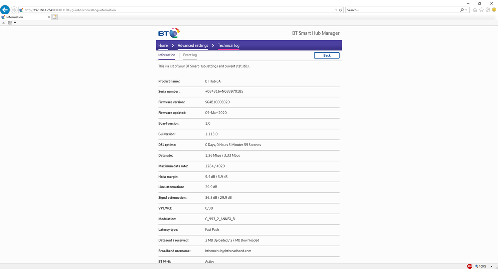

in order for the forum members to help please can you post the stats from your router (if hub enter 192.168.1.254 in your browser) and if  HH5 then go to troubleshooting then helpdesk and if HH6/SH2 then advanced settings then technical log information .

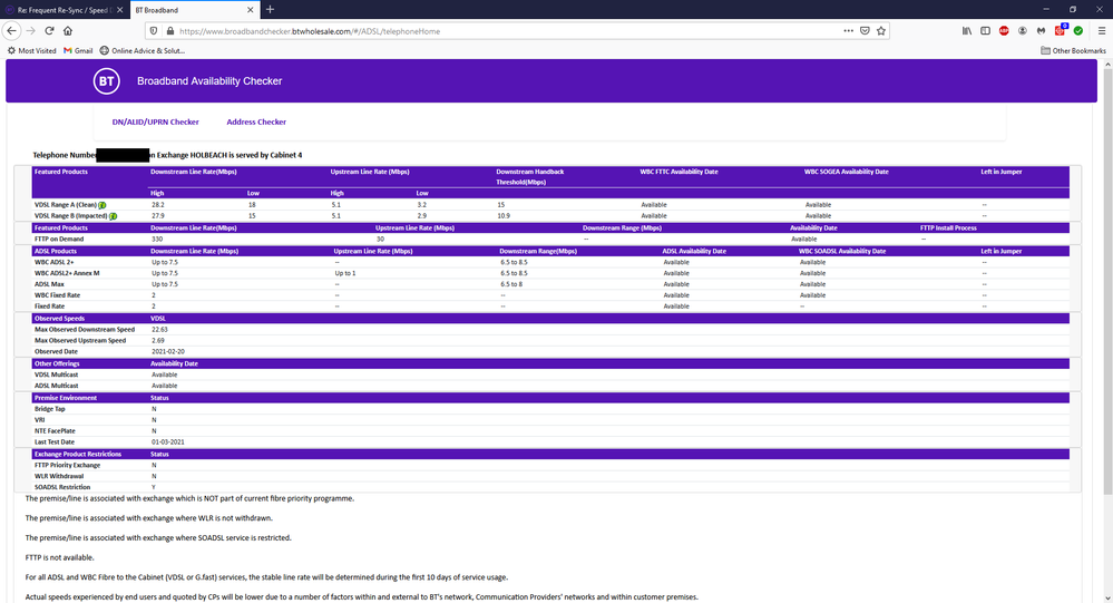

enter your phone number and post results  remember to delete number   https://www.broadbandchecker.btwholesale.com/#/ADSL

Router Stats:Router Stats page 1Router Stats page 1Router Stats page 2Router Stats page 2
Broadband checker results:

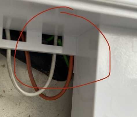

Just out of curiosity, when I was testing using the test socket, I noted this green cable which appeared to be disconnected in the master socket. Does anyone have any idea what it is for and why it might be disconnected?

Your incoming cable will have 2 twisted pairs but only one pair is used.
