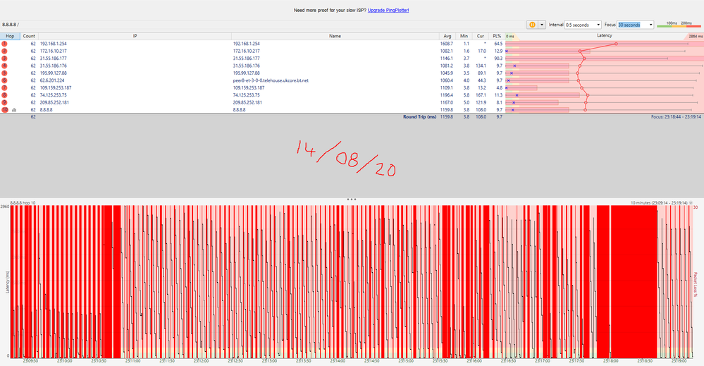

Is this anything to do with it?

Doubt it. You could try changing wireless mode in the hub, there are 3 to choose from. Use trial and error to find the best.

I have tried changing the mode, which had no effect. I also tried changing the wifi channels to ones that weren't frequented much in my street (there's only a couple of other routers nearby anyway), which also had little to no effect. Today the ping spikes have reached an all time high, to the point where the internet was nearly unusable. I believe our house was the first on the street to receive this new package, and the technician had to reroute some new cable specifically for it - do you think the install was done so wrong? The technician even admitted on the day that the speeds weren't as high as he'd like but that they'd be faster than we had before...

Don't forget the wired test was fine. This is just a wireless problem. I live in a tiny flat and I can be 2 meters from the router connected via 2.4ghz and get a really bad connection, even though I'm on a better channel, with 2 or 3 other neighbours being picked up. I disabled 2.4ghz in the router settings and just left 5ghz enabled and it improved things a lot even though the 2.4ghz bands didn't seem that congested. If your walls between rooms are not solid, you might get better speeds doing this. Could also be the wirelesss network adapter in the PC.
Have a walk around the house and do speed tests in each room/ area, figure out where it is better/worse, then maybe see if anything else could be causing the problem. Can you do this using your mobile? Do you still get bad speeds/ping spikes if you stand right next to the router? Could be a faulty router, if you rule out everything else, but proving it to BT might be a challange. What router did you have before upgrading? Was it still the smart hub? or the home hub 6 or whatever?

In the pingplotter software, if you get one hop that is 100% packetloss or near to it, I would just ignore it, just means that part doesn't respond to them. I know the 31. IP's are always like this, tried it myself.

Likewise I'm not too worried about the pingloss on the 31.xxx.xxx.xxx IP, I'm aware that some routers filter out ICMP requests as they're 'low priority', but find it a bit worrying that the packetloss for the IP for our router is around 50%. Guessing the same priority cancellation is going on here?

I get the same packetloss using the same program, pretty sure it's just the router rejecting the ICMP requests. The smart hub two has 7 internal antennas, so really the signal will go everywhere, the whole 360 degrees and is one of the best I think. There is def some kind of interference going on if your phone only gets 40 odd down also. If you still get bad speeds, literally standing next to your router, then upgrading anything WiFi related is prob not worth it unless the router itself is faulty, as you will always get some latency as there is clearly intereference from somewhere.
You could try contacting BT via the live chat, explain that standing next to the router gives bad WiFi speeds and that the router might be faulty, they may be willing to send a replacement. It's unlikely to be the cause though I think and without the expensive equipment engineers use to measure interference, it's hard to pin down. Or if you have the dosh, you could get the mesh system.
