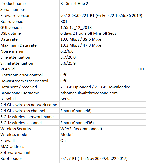

can you post hub stats  advanced settings then technical log information
enter your phone and post results  remember delete number but leave exchange and cab    https://www.dslchecker.bt.com/adsl/adslchecker.welcome

Current speed at the router is 39.605Mbps down and 9.993Mbps Up...

please can you post the actual full stats from advanced settings then technical log information (note not the actual technical log)

have you tried using the test socket with a filter to see if that improves your connection speed/attainable speed?
is there any line noise  dial 17070 option 2 should be silent and best with corded phone from test socket
